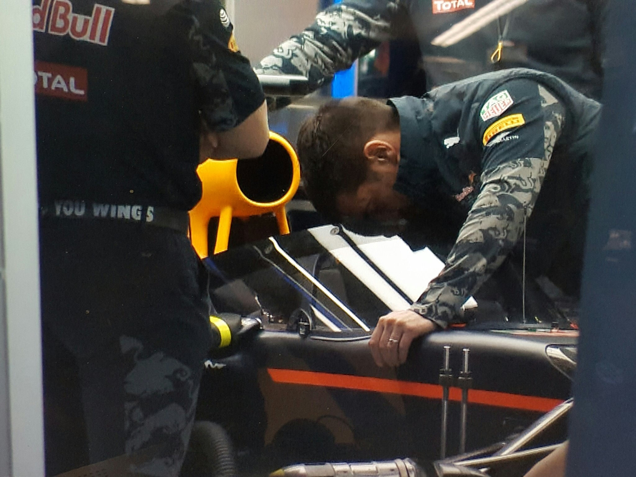

By the way: motorsport.com: Red Bull will run canopy system in Russian GP practice
