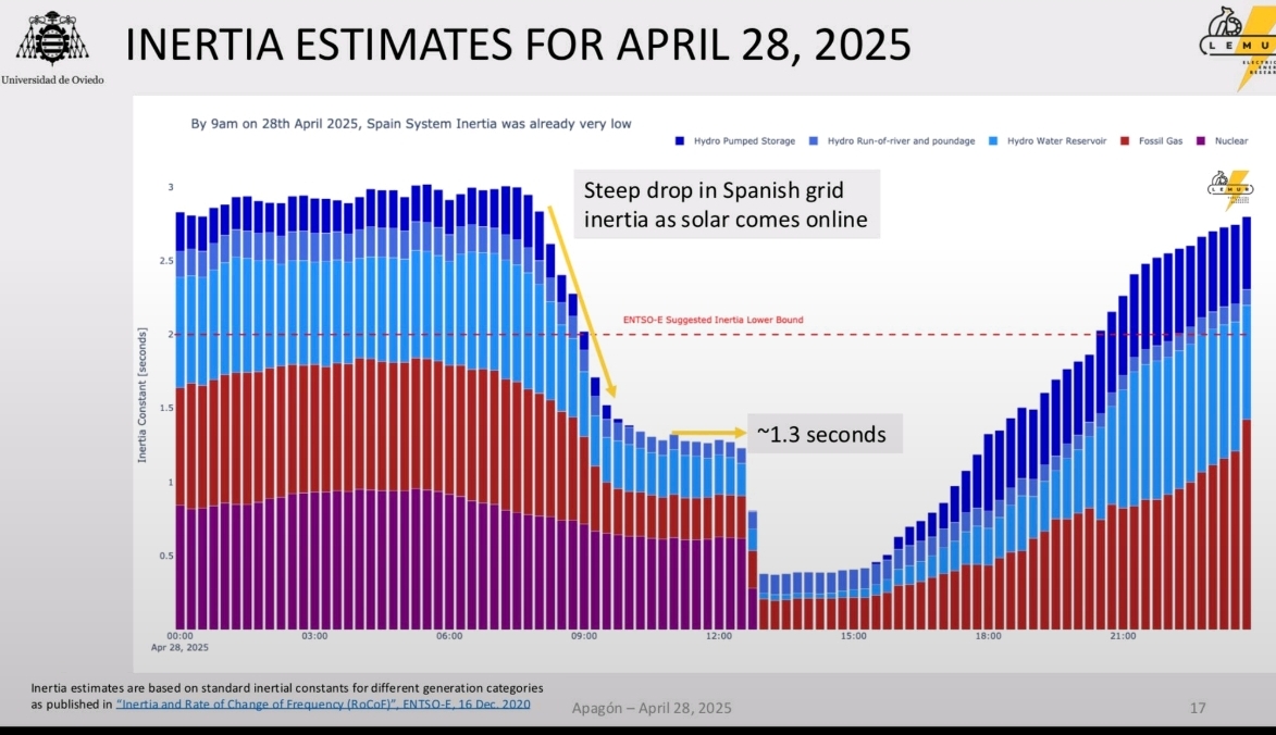

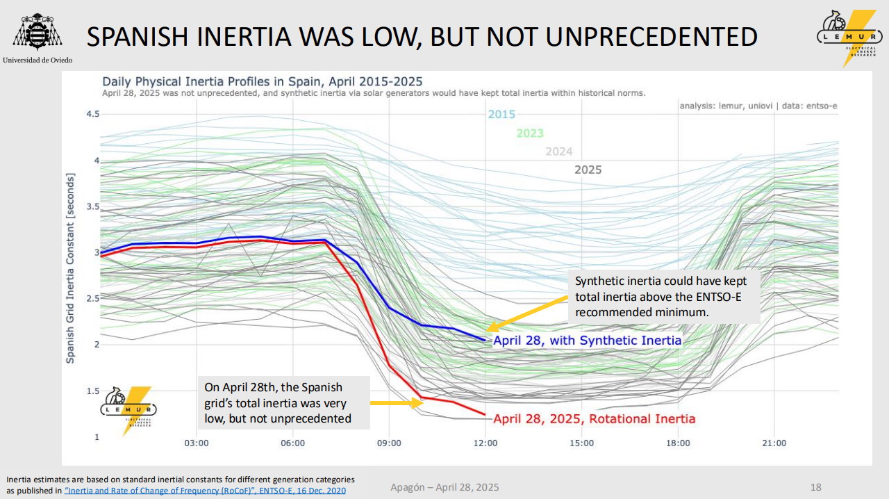

Cel PDF: https://media.licdn.com/dms/document/me...
Tudi tole:
 redno nizka inercija
