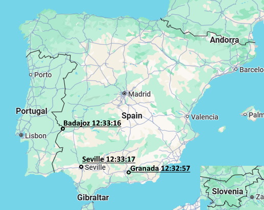

Wiki:12:03 – 12:07 CEST – first period of oscillations in the grid detected and mitigated.Nikjer nisem opazil, da bi se oscilacije pojavile tudi v tretje. Kakšen vir za to?
12:19 – 12:21 CEST – second period of oscillations in the grid detected and mitigated. Since then the grid appeared stable, with no oscillations detected.
12:32:57 – 12:33:17 CEST – a series of generation trips in southern Spain, the first near Granada, the second near Badajoz and the third near Seville causes a loss of 2200 MW in generation capacity.[24] Frequency decreased and voltage increased.
Za občutek: v 20 sekundah so se odklopile 3 elektrarne, skupne moči kot 3 naše jedrske v Krškem.
Zakaj se je odklopila prva?
Zakaj v 19 sekundah sistem ni odreagiral v +?
Zakaj sta se druga in tretja odklopili skoraj istočasno?
Bomo zvedeli ...

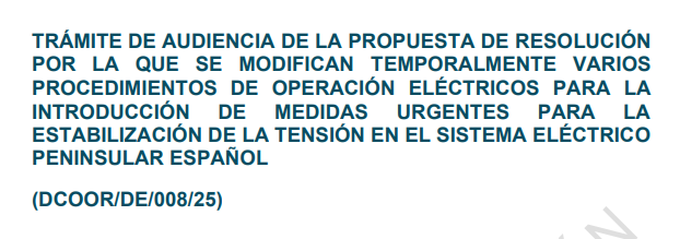

Spain's Grid Warns Power Supply at Risk after Voltage Swings - Can Texas and California learn from their mistakes?
Predlog, spremebe...
Vzroki :
The rapid voltage variations recorded in the last two weeks, even though the voltages are always within the established margins, can potentially trigger demand and/or generation disconnections that end up destabilizing the electrical system.
The evolution of the system in recent years has caused these dynamics to now begin to appear.
This is due to various factors, the most relevant of which are:
o Significant growth in facilities connected to the system via power electronics and a high concentration at certain points. These facilities can modify their power in a few seconds, practically in "steps."
o The active participation of these technologies in different market segments increases the likelihood of ever-increasing production fluctuations.
o These technologies do not regulate voltage continuously.
