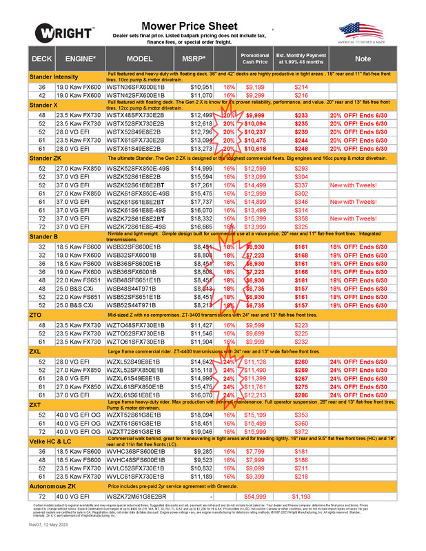

Robotska avtonoma kosilnica po Ameriško za velike površine z Wright Stander ZK (to je zero mover (se obrne na mestu), kjer kosec stoji, bencinski motor, za prenos na kolesa skrbita 2 hidro motorja), pokosi do 9 aker (9*4046 m^2) na uro
Video je iz https://www.wrightmfg.com/products/mowe... , vendar so lockani na ZDA IP naslove.
40 HP VANGUARD ENGINE
HYDRO-GEAR SMARTEC HSA DRIVE-BY-WIRE 12cc
15.5 GALLON FUEL
ROBOTIC READY SENSOR SUITE
4 DEPTH-SENSING CAMERAS
1 MACHINE LEARNING CAMERA
AUTONOMOUS MOWING SOFTWARE
What is it? We are partnered with Greenzie to build a productive, safe, and affordable autonomous mower to help you get more done in less time. The mower is based on a Stander® ZK with modifications like the 40HP EFI engine, Smartec Drive-by-Wire, 1 Machine Learning camera, and 4 Depth-sensing cameras to safely get the job done while you manage.
cene iz zda strani
