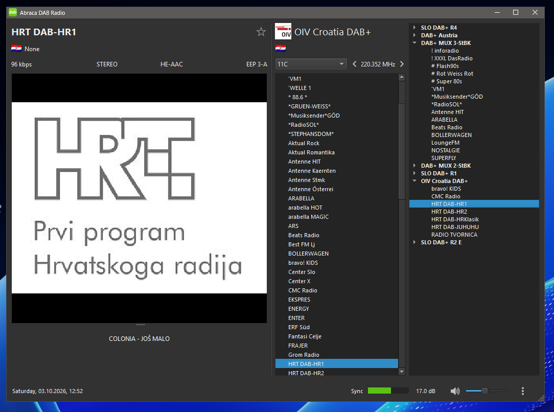

Opazil sem zelo zanimivo nihanje.
Čez dan prične se okoli 9. ure zjutraj dobim 18.6dB iz ivanščice, signal naenkrat poskoči na 18-19dB
Potem pa signal proti večeru pade na 5dB in ga iz teh 5-6dB ne moreš več pridobiti.
Včeraj ob 13 uri, 18.3dB - Spreminjal nisem čisto nič, tudi računalnik je ostal prižgan 24/7:
Danes Zjutraj:
Sem jim tudi pisal na OIV ampak trdijo da nimajo vzdrževalnih del ali da bi kaj opazili na oddajniku, bodo pa spremljali.
Vsi drugi oddajniki ostanejo enaki kaj se tiče SNRja, tudi v okolici 200MHz ni razlik razen HRT.
Trenutno ne dobim nič, saj niti zvoka ne more Abraca DAB dekodirat:
Danes Zjutraj:

Zagotovo pa je nekaj narobe na samem oddajniku, saj je sedaj od 9. ure 19-20dB, pri meni osebno nisem nič spreminjal, ta računalnik je prižgan že 3 dni z DAB+ USB donglom software je tudi že prižgan 3 dni, kablov noben ni menjal niti nič premikal, je pa antena na strehi, Made in japan original.

Signal se drži na okoli 18.2dB tako, da so zgleda morali včeraj nekaj popravit.

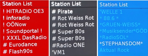

Dunajski City mux na K11C za zdaj edini ima podatkovni kanal ASA Info v svoji programski shemi.

Please don't rely on cheap RTLSDR sticks, especially when you are using them 24/7 like for your observations.
Always check their temperature. If they are too hot, they will behave strange.
And check reception in your car or on other places.
I have the same problem like you that Slovene R2W becomes either 6dB or 20dB, it's also a local effect (amplifier and other parts). If you want, I can send you diagrams of 24/7 recording (see FMLIST URDS) where the signal gets down as described from you. This is NOT a problem of the operator.
I am not using cheap RTLSDR's but professional high end SDR.
https://www.nooelec.com/store/sdr/sdr-r...
With roof antenna, this one doesn't get hot as it has very good cooling with aluminium.
I am using high end PC config for DAB+ tests:
ASUS TUF GAMING B550M-PLUS WIFI II
AMD RYZEN 9 5950X
ASUS GTX 1070 DUAL
64GB RAM DDR4 3200MHz
X-Fi Elite PRO (PCie to PCI bridge)
Diamond Antenna Discone antenna 130J - on roof
Windows Server 2025
USB3.0: Nooelec NESDR SMArt v5
Software Abraca DAB radio open source
But i never trust those RTLSDR's so i always check other DAB+ tuners:
- JBL Tuner XL - (very good sensitivity and reception)
- Sony XDR V20D - better than tuner XL
All 3 tuners had almost 0 signal, around 4-6dB SNR and audio cutouts.
Currently, HRT1 from ivanščica is stable for more than 48 hours without a single drop, staying at 18.1dB, same on other tuners, JBL and Sony 0 errors.

Spc ::
Pri meni je sedaj ivanščica zelo stabilna vse dni od kar so popravili (slika zgoraj).
Danes imam 17.6dB brez ene prekinitve, tudi ponoči ali čez dan ni bilo prekinitev več.
- spremenil: Spc ()

V začetku leta sem spravil na kup programe z začetka programske liste, ki pred svojim nazivom imajo posebne znake. Vsi so seveda avstrijski. Podvojene programe sem odstranil. Situacija je bila takšna.
Med časom se je seznam nekoliko razširil. Na zadnje je avstrijski Inforadio, z namenom optimizacije pozicije na programski listi, dodal posebni znak pred nazivom in tako prišel v ospredje seznama programov po abecedi.
Spodaj je trenutni vrstni red. Ta sprejemnik sicer ne podpira prikaza podvojenih programov, sta pa prisotna po 2x RWR in Super 80s, zaradi različnih ID-jev. Rot Weiss Rot z enega oddajnika pri Dunaju ima ID ADCA, s Schöckla pa ADCB, zato je pred njim. Program Super 80s ima ID ADCF, zato je prav tako pred tistim s Schöckla z ID ADD0. In tako je naš Aktual Rock prvi program brez kakšnega posebnega znaka na (komaj) 21. mestu.
Pri nas to ni tako pomembno, morda pa se bo kdo na vzhodu ali vzdolž avstrijske meje pozabaval s tem. Še dobro, da imamo možnost shranjevanja priljubljenih postaj.
Trenutni vrstni red teh (pred)znakov je naslednji:
1. ! (klicaj),
2. # (lojtra),
3. ' (apostrof) in
4. * (zvezdica).
Ugotavljam, da je vrstni red odvisen od HTML kode znaka, kot se vidi spodaj v tabeli.
Se pravi, da bi v tej situaciji neki program prišel na 1. mesto, bi spredaj mogel imeti presledek. Morda si bo to zmislil kateri od naših programov, ki v bližnji prihodnosti pridejo v mux R5.
1. ! (klicaj),
2. # (lojtra),
3. ' (apostrof) in
4. * (zvezdica).

Spc ::
Tukaj sem imel še no service - 24.9.2026 ob 9:01
Potem pa je nazaj prišel signal - 24.9.2026 ob 9:04 - 9:08
Od 24.9, 9:04 do danes več ni težav na ivanščici, zadeva deluje brez ene napake.
Trenutno 17.3dB in tako ostaja po cele dneve, računalnik je prižgan 24/7.
Trenutni signal:
Trenutni signal:
- spremenil: Spc ()

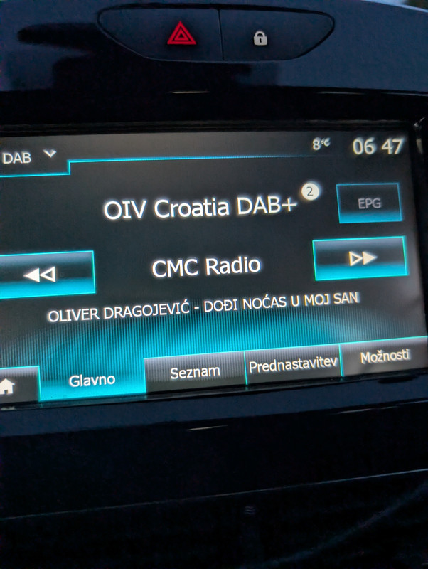

V novejših avtomobilih pri nas ne bi smelo biti težav. "Težavo" imajo bolj eni stacionarni sprejemniki, ki lahko prikažejo vse mogoče in nemogoče črke, velikega Đ pa ne. To se lahko najbolj vidi trenutno na CMC-ju, kjer predvajajo naziv skladbe in izvajalca. Sem takrat hkrati v avtu preveril besedilo z leve slike in je OK. Captur letnik 2023.
Renault Clio 2017, črke se na CMC radiu prikazujejo pravilno
herdarko ::
Ja, OK. Sej pravim, v avtih je nekako samoumevno, da tudi takšne črke sistem prikazuje pravilno. Težave so lahko bolj na posameznih prenosnih in stacionarnih sprejemnikih, tudi novejše proizvodnje. In ne samo s črko Đ, ampak nasploh s šumniki.
Kako pa ti prikazuje logote in sličice posameznih postaj v avtu? Pri meni se lahko vidi zapečeni logo postaje v ozadju, na levi strani pa je prostor za Slideshow (logo, ovitki albumov, vreme, …).
