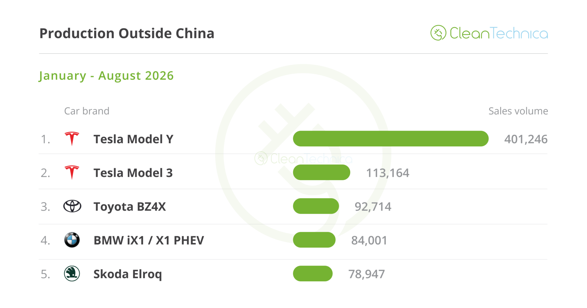

Naletel na zanimiva članka:
Top Selling Electric Vehicles in the World -- 27% EV Share in August!
in
Europe EV Sales Report: Record Month -- BEVs Reach 30% Market Share!
... predvsem pri prvem je zanimivo, da se na te lestvice uvršča tudi Toyota:
in
But, for me, the biggest surprise of the month ended up in 19th place. After a few years of absence, the Toyota RAV4 PHEV returned to the table!
Yep, thanks to its new generation and a global rollout (finally!), the Japanese SUV is back at the table, and with close to 14,000 registrations! That is almost double what the previous generation of the RAV4 PHEV peaked at, so expect this model to probably become the star plugin player in Toyota's lineup, surpassing the all-electric BZ4X.
But it's below the Teslas that things get interesting. The best sellers of last year (VW ID.4, Hyundai IONIQ 5, Audi Q4) were all kicked out of the top 5, and we now have new faces on the table -- the Toyota BZ4X is 3rd, followed by the BMW twins the iX1 and X1 PHEV, while the Skoda Elroq closes out the top 5.
The Toyota model in particular is striking, because its sales/production are up by 116% YoY! Toyota is rising....

Ce ze zraven dajejo hibride na te lestvice, niti ni cudno, da je Toyota nekje tam. Je pa res, da jim ni lahko tekmovati proti BEV in kitajskim PHEV vozilom. Predvsem BYD.

Govorim o RAV4 PHEV, kot o velikem presenecenju:
A ni malo cudno, da je to tako presenecenje, da Toyota zleze na to lestvico (BEV+PHEV)?
BZ4 pa je BEV, itak, samo, kaj pa jim ostane drugega, da tu prodajo? Ce imas prakticno en resen model, niti ni cudno, da tega produciras v vecjih stevilkah, kot ostali prozivajalci z vsaj petimi. Skupna prodaja po znamkah bi tu pokazala nekoliko vec kje so.

codeMonkey je izjavil:
Imajo tri modele EVjev, bz4x, CHR+ ter Urban Cruiser.
codeMonkey ::
Koliko jih naredijo? Tako cez palec so skupno trenutno nekje na polovici VAG na tem podrocju. Sicer je ta vse manj relevanten, ampak sta nekako bila izenacena preden so se BEV in PHEV vozila res zacela prozivajati v vecjih stevilkah. VAG je od tedaj relativno izgubil nekaj v celotni prodaji, je pa spredaj na BEV+PHEV podrocju (kar je meni res cudno glede na to kako so kot vodilni zaceli s HEV). Oba pa drsita po lestvicah dol.
