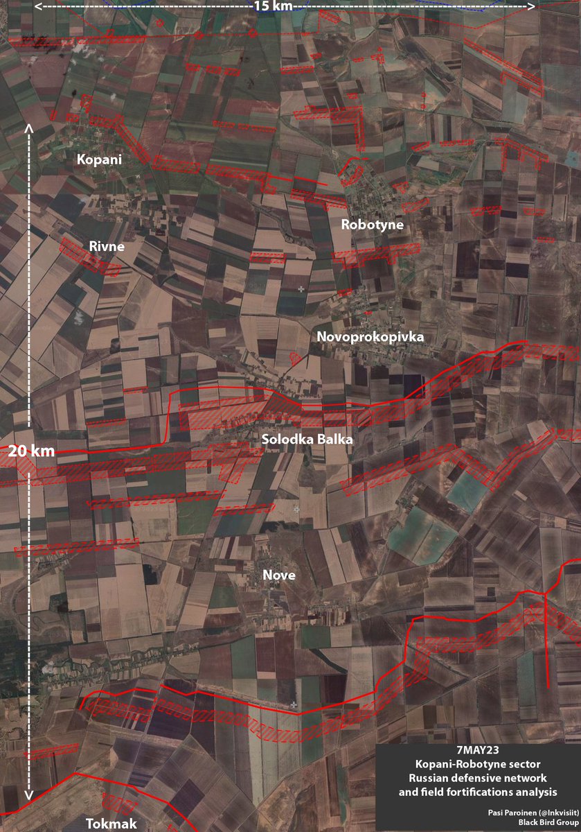

https://twitter.com/Inkvisiit/status/16...
Thread: Analysis of Russian defensive network and field fortifications on Kopani-Robotyne-Tokmak sector of the Zaporizhzhia front. This analysis was done using Sentinel Hub EO imagery and commercially available very high-resolution satellite imagery by Airbus DS Pléiades Neo.

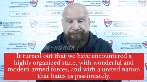

Russian independent journalist Daniil Belovodyev gave Wagner a call and pretended to be interested in signing up. He asked them about the difference between going to Ukraine and Africa.
8-)

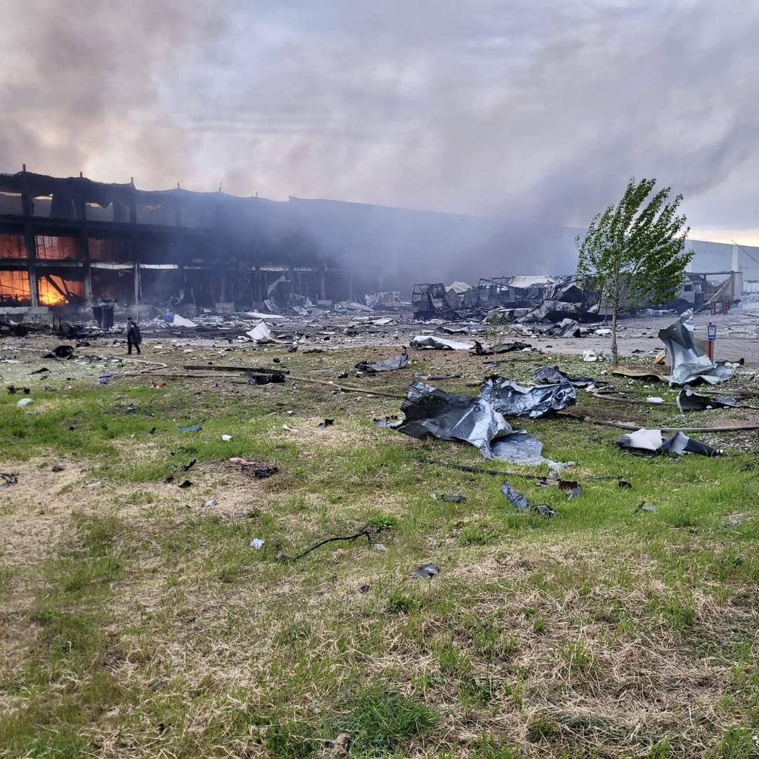

🔴 On May 8, a 1,000-square-meter warehouse of the Ukrainian Red Cross Odesa Regional Organization was destroyed by a missile strike on the city of Odesa. The fire entirely destroyed the humanitarian aid stored in the warehouse.
za bruhat
One dead as missile strikes destroy Red Cross warehouse in Odesa
Kyiv, May 8 (EFE).- A warehouse in Odesa being used by the Red Cross to store humanitarian supplies was destroyed in a fire caused by an overnight Russian missile attack, the organization said Monday, which military sources said killed one person.
"On May 8, a 1,000-square-meter warehouse of the Ukrainian Red Cross Odesa Regional Organization was destroyed by a missile strike on the city of Odesa. The fire entirely destroyed the humanitarian aid stored in the warehouse," the Ukrainian Red Cross said on Twitter.
