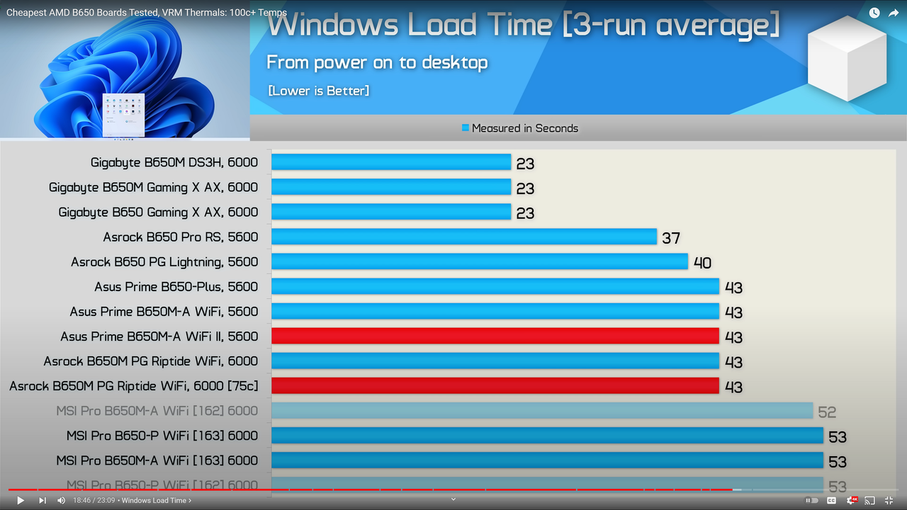

Pa še boot time bodo do takrat hopefully porihtali:
Izklapljati memory context restore ni tako nedolžno, kot se sliši.
https://www.reddit.com/r/buildapc/comme...
Good timing, I spent this entire past weekend testing and swapping stuff and asking around after my RAM corrupted my OS. Our boards are basically the same with a different layer of paint...Do you have the 5600 or the 6000Mhz set? I sorta have a theory on what may be happening now and everything seems to be stable, but obviously I need to keep watching it for a bit longer...
I got my OS totally corrupted (BSOD loop of memory and driver related failure) twice over the 2 months on the 5600Mhz sticks, first time was because I turned off memory training and the EXPO wasn't stable, kinda my fault. MEMTEST found no errors. Second time was this past weekend. I was running the sticks on JEDEC speeds since the first corruption, and it out of the blue totally corrupted my OS again. I ran MEMTEST immediately this time with CPU and RAM on bone stock settings, and it gave me over 10K errors in the first 3 minutes, but the failure was not reproducible. Both sticks tested good on single sticks, and when I inserted both sticks back, I did not get any errors either. But I could not trust the RAM, or the system in general at this point, and I went ahead and swapped the RAM, the new RAM are the 6000Mhz sticks, same GSKILL brand, also on QVL.
Sam se ga testno izklopil (bil na auto), bootal v winse in dobil v prvi minuti bsod (pc idlal na desktopu) in nato po rebootu še 1x (vsakič drugačen, prvič da je nekaj narobe z %Windir%\System32\ci.dll [code integrity module], drugič irql not less or equal), ko sem zagnal web browser).
Ter v %Windir%\System32\LogFiles\Srt\DISMRepairLogFile.txt en kup napak tipa:
Failed to find a matching version for servicing stack:...tako da moram sedaj zagnati še sfc/scannow, chkdsk ter dism da vidim če je vse v redu https://www.windowscentral.com/how-use-... .
Posledično sem dal nazaj na auto, bios je zadnji (msi b650 tomahawk, rami 2x16gb na 5600 Mhz expo, pbo & cpb na off https://www.pugetsystems.com/labs/artic... ).
- spremenilo: sbawe64 ()

MSI rant
Džabe novi procesorji x3D, še za stare zen 4 ne znajo spraviti ven biosa brez par kolonij hroščev (5 mesecev po izidu, 22/9 2022).
Da ne omenjam dolgih boot časov.
https://forum-en.msi.com/index.php?thre...
Nekaj testiram različne kombinacije
pbo on/off (oz manual s curve), cbs (cpb) on/off
najbolj hladna kombinacija, testiram v 7zip 22.01 x64 bench [compressing/decompressing resulting], 20 passov, HWMonitor za temperature, zaprto ohišje na mizi, temp 22C:
pbo on (manual, -29 curve, če dam na -30 je preveč - reboot med benchom), cbs (cpb) off
87825, 94331, temp cpu do 68C
nekaj vmes
pbo off, cbs (cpb) off
87657, 94592 (compressing/decompressing resulting), temp cpu do 80C
najbolj hitra (in vroča) kombinacija
pbo on (-29 curve), cbs (cpb) on
91753, 100855, temp cpu do 97C
pbo on, cbs (cpb) off
//ne pride do konca test - reboot med benchom
7600x, rami kingston 5600 expo cl36 38 38 80 118 (prepisano iz cpu-z), msi b650 tomahawk, zadnji stable bios 7D75v11 (tile beta 31/34 so brez komentarja, škoda časa, testiral oba, nestabilno v PM), vodno 360 - 3x 120 mm ventilatorji omejeni do 1200 rpm, win10 pro, power plan ultimate performance https://www.howtogeek.com/368781/how-to... .
V biosu imam "Spread spectrum" na off, memory context restore je na enabled (v tej verziji biosa recimo da dela, v naslednjih beta ne),
drugega iz OC sekcije nisem spreminjal.

For example, with 1.0.0.4 it took about 40-45 seconds in POST which is still super slow, but with 1.0.0.5 that time increased to a whole minute, so overall it takes almost 2 minutes to boot into Windows 10.
Leto 1999: Intel(R) Core™2 Duo processor, 128Gb HDD@5400rpm: boot time to windows ~110 sekund
Leto 2023: Ryzen 7900X, 1TB PCI-E 5.0 SSD; boot time to windows ~120 sekund

Na HU so komentirali, da je daljši zagonski čas povezan s treniranjem DDR5, ki se zgodi ob določenih spremembah v BIOS-u.
Sicer je primerljivo kratek.

To nastavitev v BIOSu omogočiš in potem je čas zagona vredu.
Meni se je tudi čudno zdelo. Potem sem pa malo bral.
Na Asuski sem omogočil "Memory Context Restore" in se je zadeva uredila.
Ne vem pa, kako se ta nadtavitev imenuje na drugih matičnih ploščah.

Še en rant na msi bios (zadnji stable v11): ko nekaj spremenim in pritisnem F10, pokaže v ang jeziku vmesnika (privzet jezik) prazen dialog box z ok in cancel, če dam v nemščino, francoščino, španščino pokaže katere spremembe sem naredil ter ok in cancel.
@Jarno
Vsaj na MSI ploščah očitno ni stabilno:
The option that helps reducing boot times is Memory Context Restore set to enabled, but it's bugged since agesa 1.0.0.4, the moment you change it from auto to either enabled or disabled, lots of BSOD happens, and MSI couldn't fixt it in this new bios either.
Memory context restore might actually work for me, but I heard people say that it causes stability issues so I prefer not to have that enabled.
- spremenil: DarwiN ()
Sem morda kaj zamudil ali preslišal?
Na beta bios v31/34 je zagonski čas skoraj minuta, vsakič.
Na v11 je prazen zaslon cca pol minute.
Edino če grem iz win v bios traja 15 sekund praznega zaslona (potem ko sem enablal memory context restore, drugače je pol minute.
