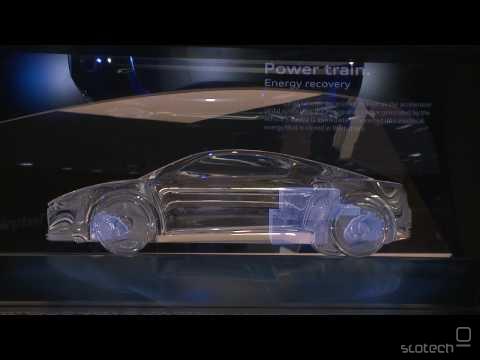

Audi še naprej razvija R8 E-Tron. Na ceste bi naj zapeljal 2013.
The R8 E-tron is powered by four motors – two on the front and two in the rear axles that each connect to their respective wheel by the use of a small shaft. By using the four motor setup this R8 delivers 313 hp and 4,500 Nm (3,319 lb-ft) of torque. It is capable of accelerating from 0 to 62 mph in 4.8 seconds.

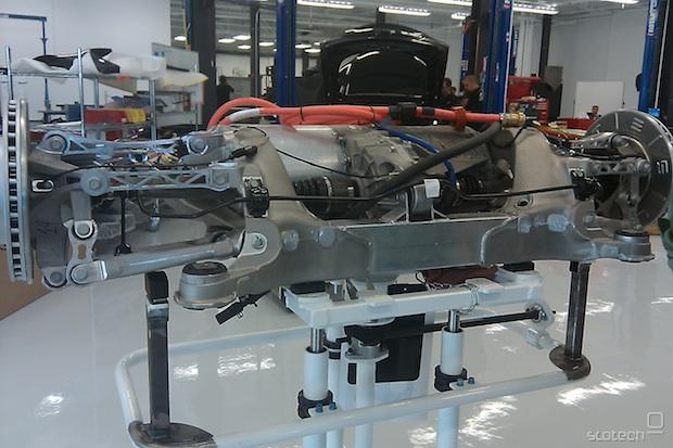

Ko celoten pogonski sklop zasede ravno prostor med obema zadnjima obesama, ni več kakega resnega dodatnega prostorskega profita ob umiku motorjev v felge:

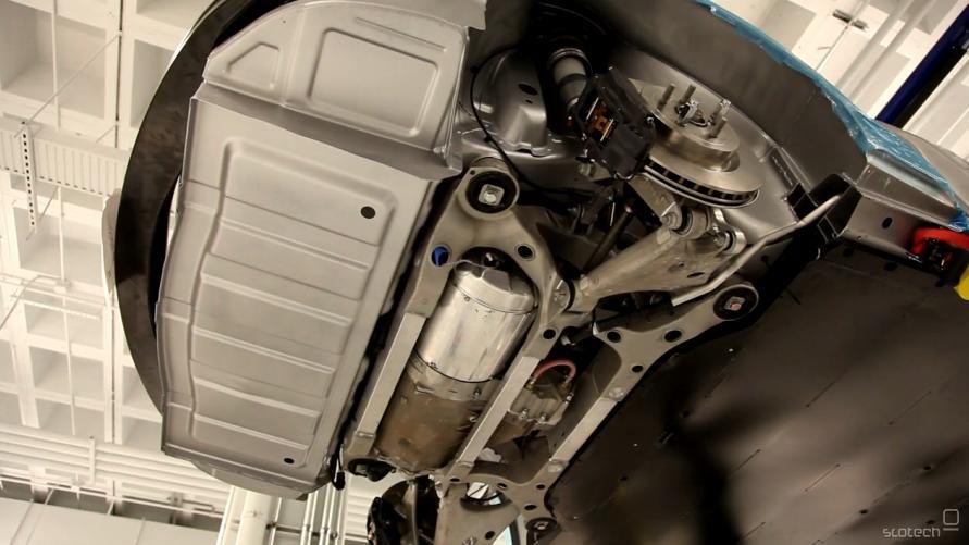

Tesla Model S motor
Model S zadnja prema
Ostane le še dodaten profit boljše porazdelitve moči med kolesa. En takle pogonski sklop še na sprednji osi požanje še večino tega neobranega profita. To naj bi bilo namenjeno za "Model S Sport" o katerem se govori, da pride kako leto kasneje (konec 2013), in za Model X, ki naj bi bil mildcrossover baziran na S (nekaj takega kot Audi Allroad, Octavia Scout ipd).

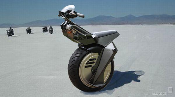

So pa tudi druge ideje, kot npr.: Ryno Elektro Scooter

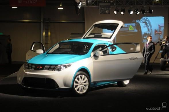

Ni kaj, duh je ušel iz steklenice in električnih zamisli avtomobilov je vse več. Tudi na daljnem vzhodu nočejo zaostajati, hočejo biti celo pri vrhu. Takšen poizkus je tudi Luxgen Neora EV Sports Sedan iz Taiwana. Sodoben avtomobil izjemnih zmogljivosti.
Yulon Motor, Taiwan’s largest automobiles maker, has released its concept of all-electric Luxgen Neora EV Sports Sedan car at the recent 2011 Shanghai Auto Show. This front wheel drive Luxgen car runs a 180-kilowatt (241 horsepower) electric induction motor, and uses a 48 kilowatt per hour lithium-ion battery that requires just an hour for an 80 percent recharge.
The car is said to have a top speed of 155.3 miles per hour. It also claims of acceleration of 0-60 mph in less than 6.5 seconds. The automaker claims that the Neora (from NEO and ERA) has a range of up to 248.5 miles when it is fully charged. The above performance figures seem quite impressive if you take in to account that the car weighs around 1,600 kg.
