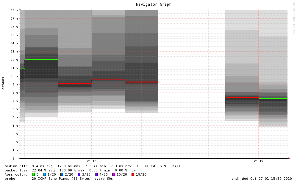

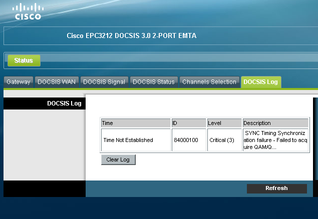

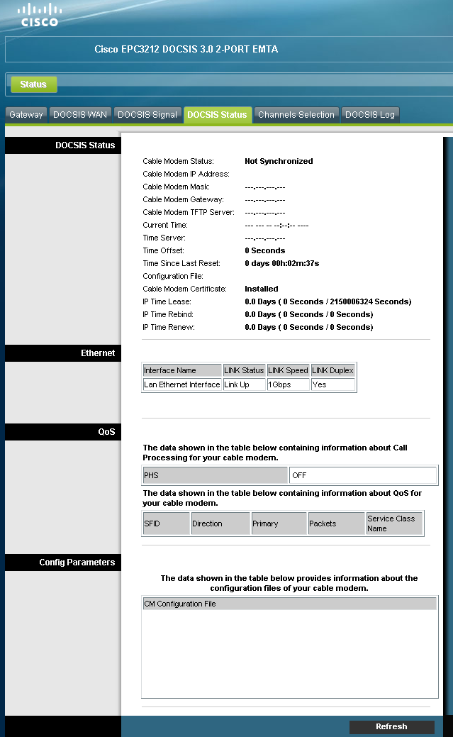

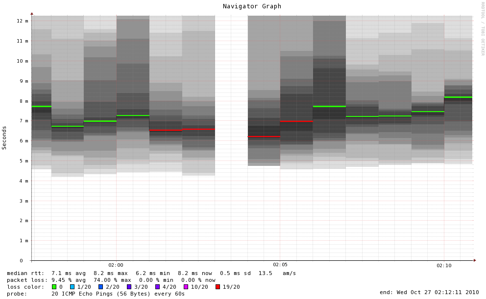

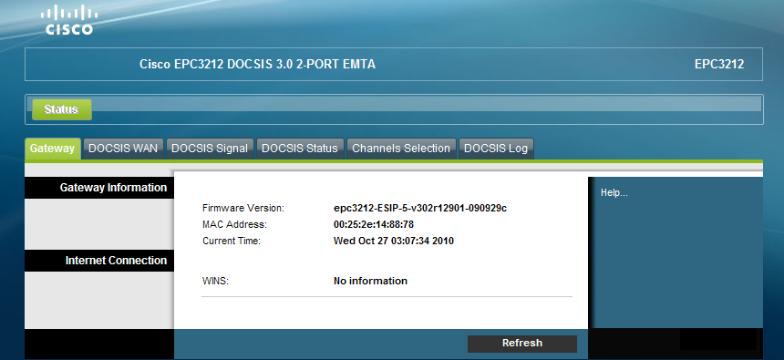

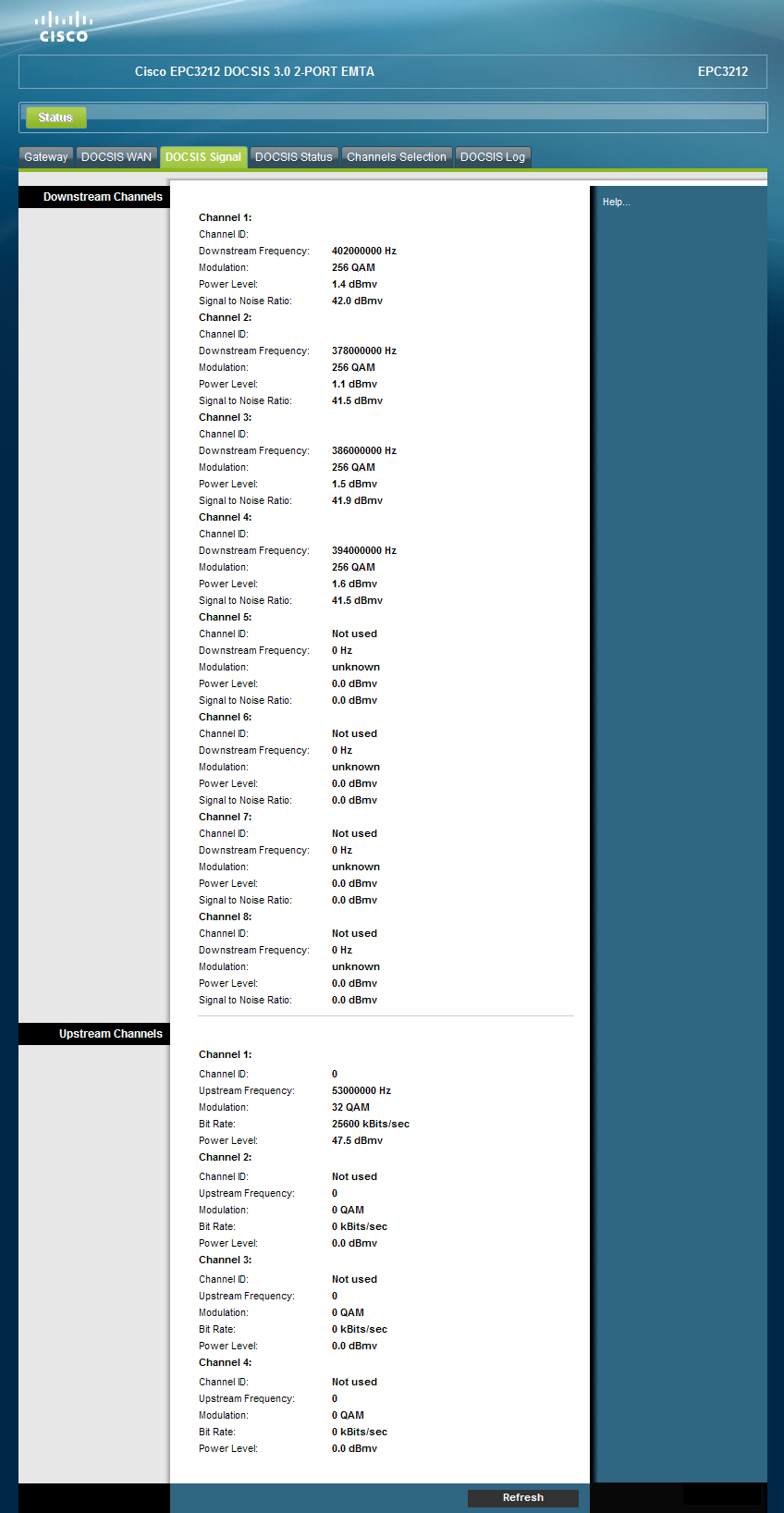

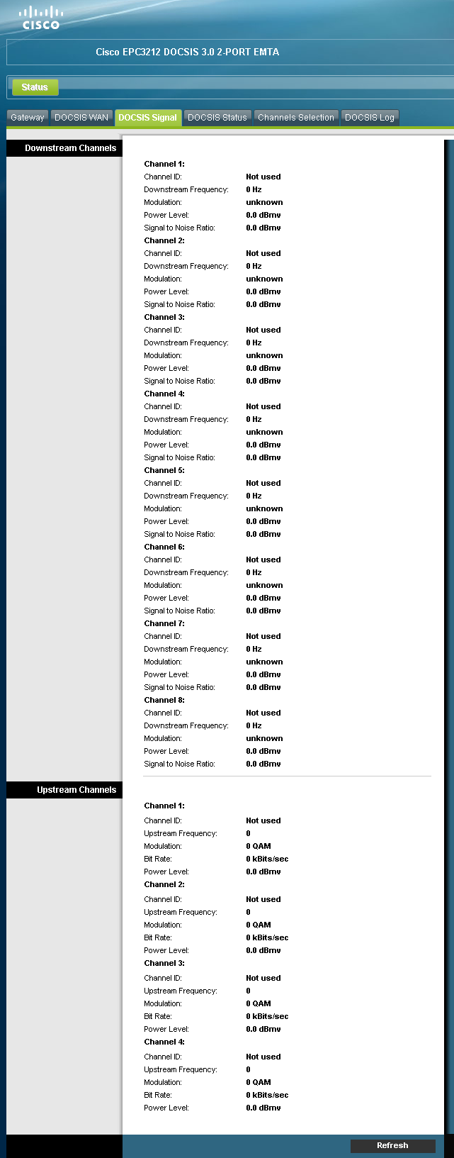

Evo spet težave.
Vsaki dan padem vsaj 7x iz interneta, zgodi pa se to:
Prekinitev za 7-15min.
Misli to telemach popravit ali bojo spet položnice zavrnjene ?
In ne ni problem v signalu ker ko se to zgodi modem ne zgubi signala.
Zgubim pa povezavo do 10.147.0.1 (neki čudni lokalni ip)..
traceroute to 213.161.0.10 (213.161.0.10), 30 hops max, 38 byte packets
1 Server (192.168.0.1) 0.047 ms 0.039 ms 0.034 ms
2 10.147.0.1 (10.147.0.1) 6.727 ms 6.815 ms 4.572 ms
3 10ge.core.ip.triera.net (213.161.2.81) 4.781 ms 9.012 ms 8.169 ms
4 charlie.ip.triera.net (213.161.2.10) 7.175 ms 7.080 ms 7.417 ms
5 ns1.triera.net (213.161.0.10) 16.758 ms 7.371 ms 5.329 ms

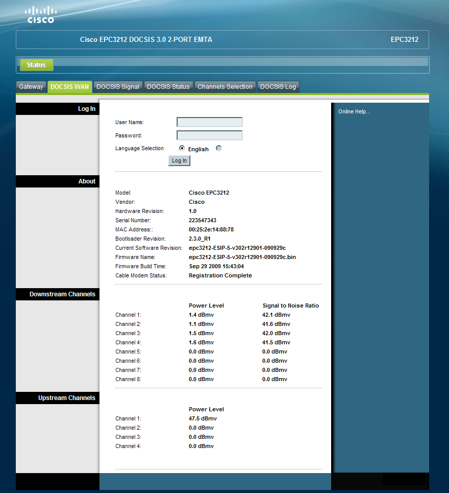

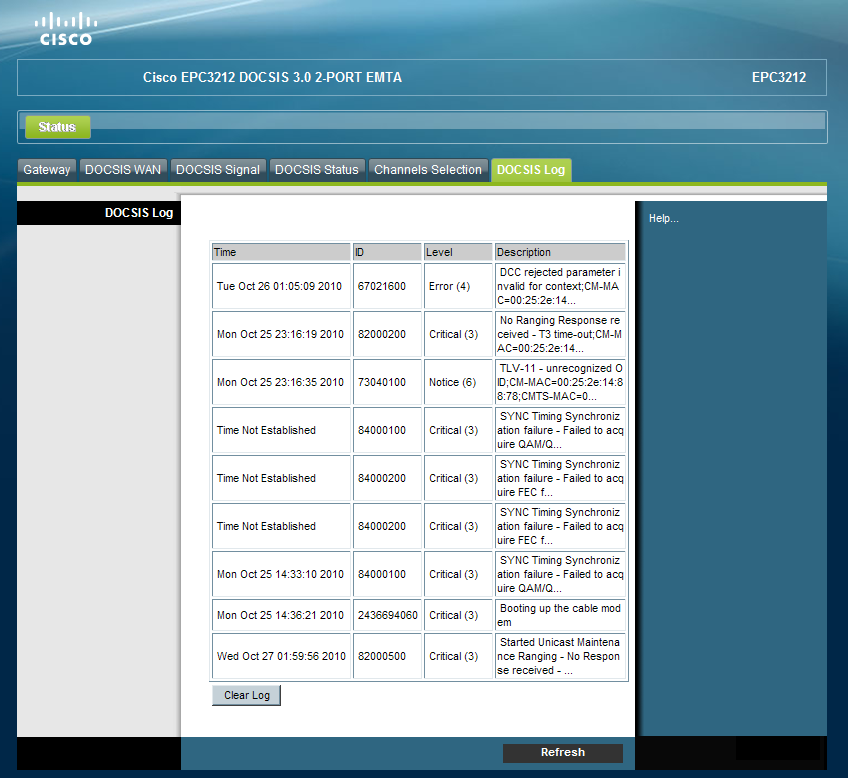

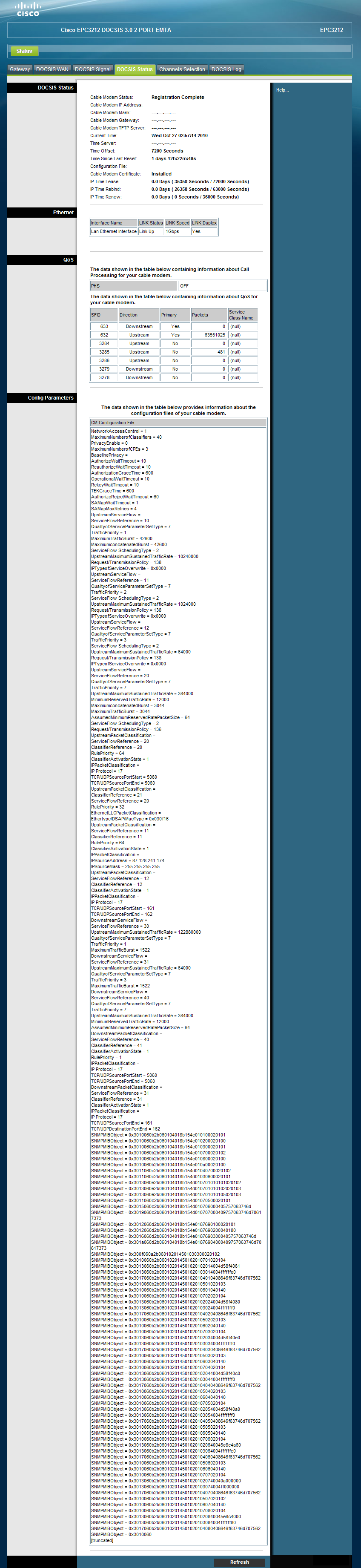

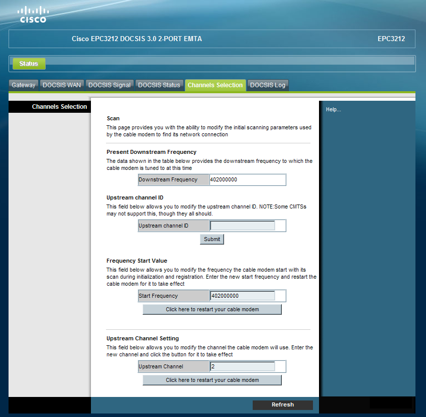

Spet (v roku 40min):
Še tretjič v roku par ur:

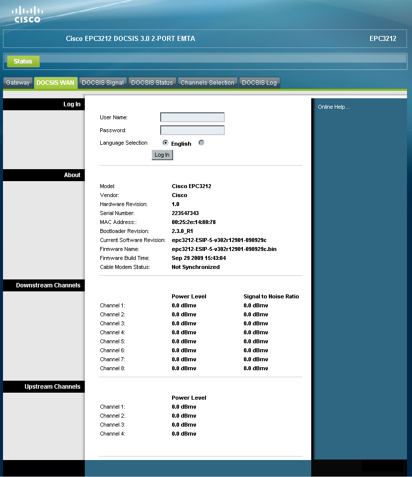

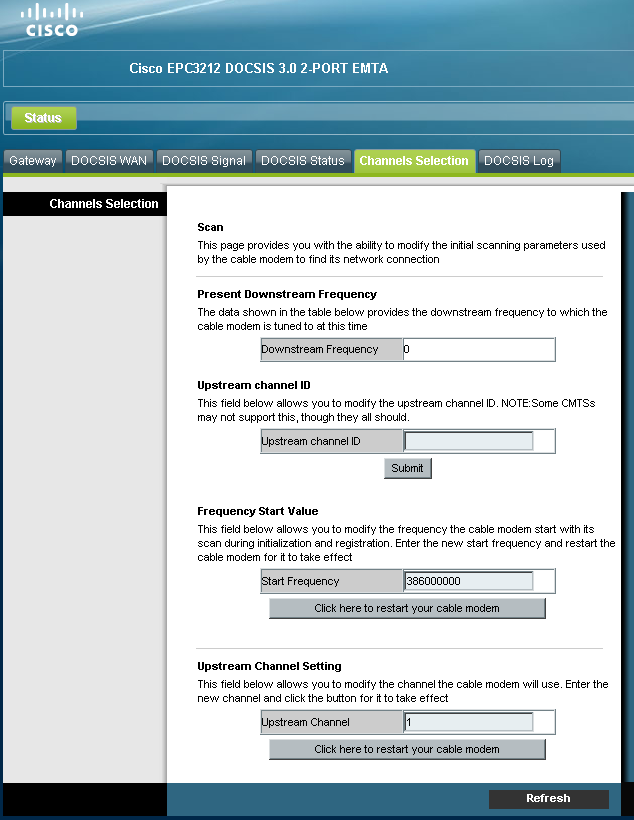

Še modem:
http://www.netsky.org/telemach/modem/cisco-Gateway.png
http://www.netsky.org/telemach/modem/cisco-DOCSISWAN.png
http://www.netsky.org/telemach/modem/cisco-DOCSISignal.png
http://www.netsky.org/telemach/modem/cisco-DOCSIStatus.png
http://www.netsky.org/telemach/modem/cisco-ChannelsSelection.png
http://www.netsky.org/telemach/modem/cisco-DOCSISLog.png
Še moj config file:
http://www.netsky.org/telemach/modem/DOCSISConfig.txt
  • spremenil: Spc ()
